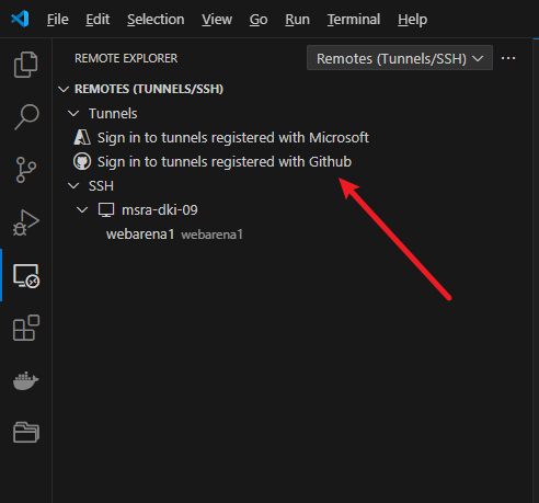

In the progress, you need to authenticate(login with your Github account)
Also you need to login with the same Github account in your local VSCode
And you can connect to the tunnel with VScode:

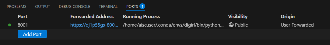

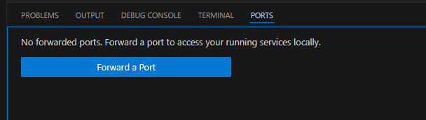

In the end, set the port forward and set it pulic:
So you can use the forwarded address(same as localhost:8001 in remote server)
